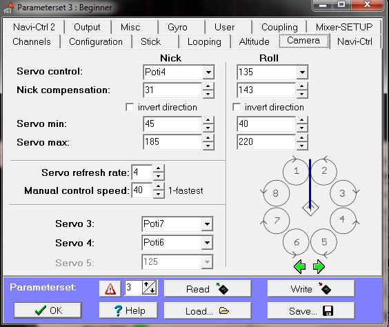

It's under the camera tab in settings. Mine is set to 4 due to my setup being different. Make sure the roll is not set to a poti. It should have a number around 125 to start.

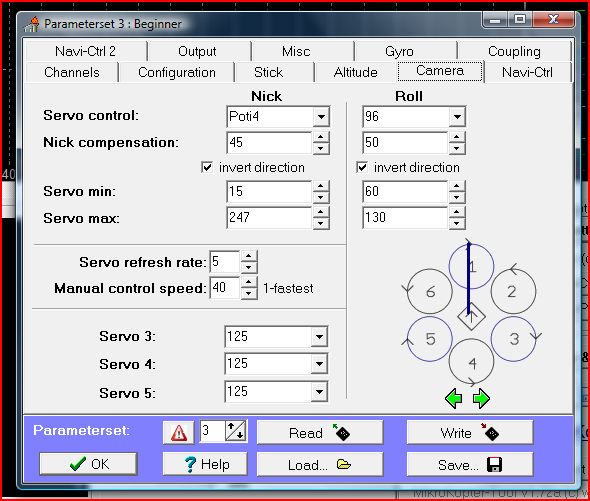

Ok Now I have that screen you have. I have a Hexa what #'s should be the same and which different. Where do I go to find that info. Shaun
Hang on buddy...slow down.. can u post a screen shot of your camera tab in MKtools.. Its late over here but I will take a look and reply while u sleep!
