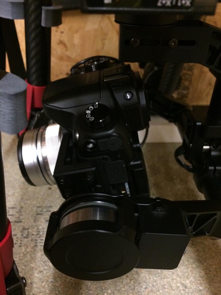

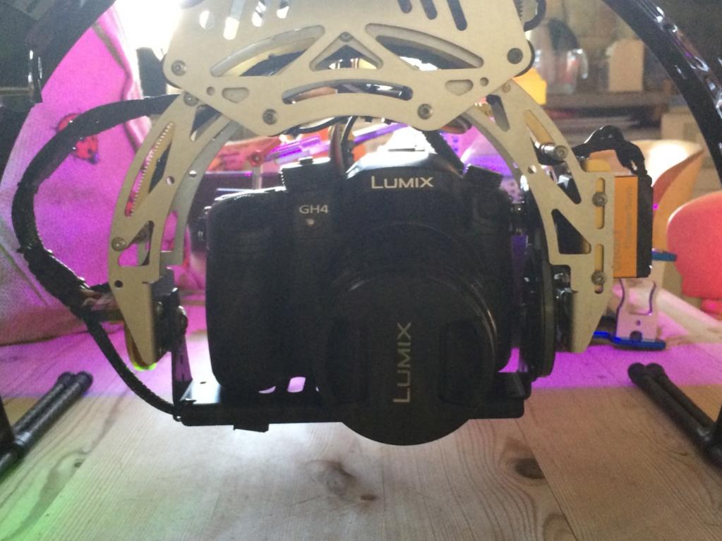

So it 'just' fits for anybody interested!
Obviously this set up is only suitable for stills.
The strap hanger on the left side of the camera body prevents perfect balance but I think I'll see if I can remove that.
Matt.View attachment 20194View attachment 20195

I found that those strap lugs also catch on the AV130 frame and prevent tilting more than a few degrees

I put a driver through mine just now and applied some leverage. They seem very tight so it might be a dremmel job!

Jim, FYI I put a hex driver through them, applied pressure and they both failed where they attach to the body. The GH4 fits perfectly on the AV130 now! I have had some great results with stills.
