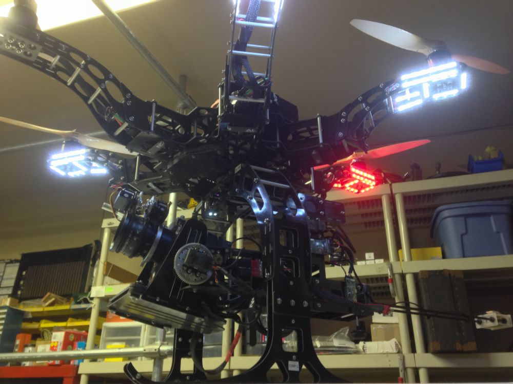

Attached is the lady.
I hope the mods dont bring down the hammer!
If anyone has any more input to my situation, Id be happy to share a bit more, you sick-o's! :)
