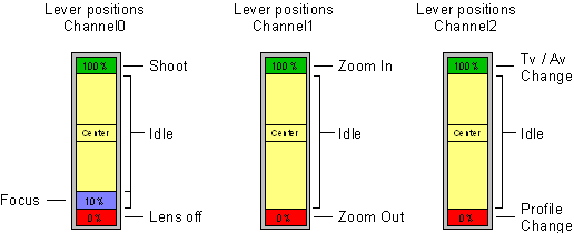

Ok Thanks for your version, it was basically the same as what I was getting ..However..
In the screenshot you sent me I seen it was set to channel 0 execute and channel 1 function..I tried this and set a pot and a stick on the controller, and it gave me loads of functions on the PC but not all worked on the camera, so I will contact them about this.
I did manage to get the focusing sorted with that setting though, so it really does look promising.
It would be abit hard to work with that setting though, as you have 2 controls which all need set exactly to get what you want, as in the picture below..
So everything works..just not as described in the manual.
This controller is great, just a bit buggy for the 5D at the moment.
