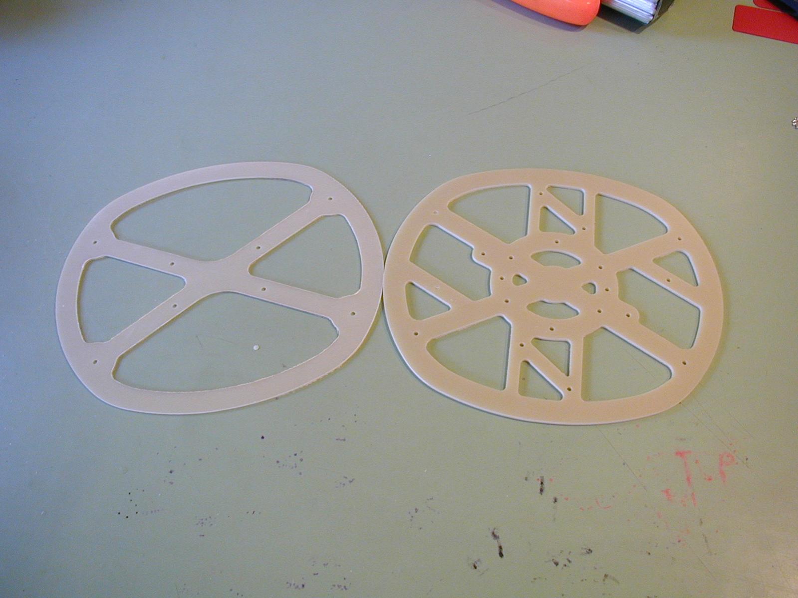

this is the shape I need to put a cover on...i can make the form but I don't have the equipment to form it. i could make a set-up but i don't have the time right now.View attachment 1315
i also would like to do something fun like mold a skull into the front of the dome.

Just make the negative form (mold) and drill a hole in the bottom. Attach a shop vac to it. Place your lexan sheet on a piece of stainless or something really flat. Heat it in the oven to about 300deg and start playing with temp/time. Should be fun once you have it dialed in. It doesnt take much vacuum if the sheet is right.
