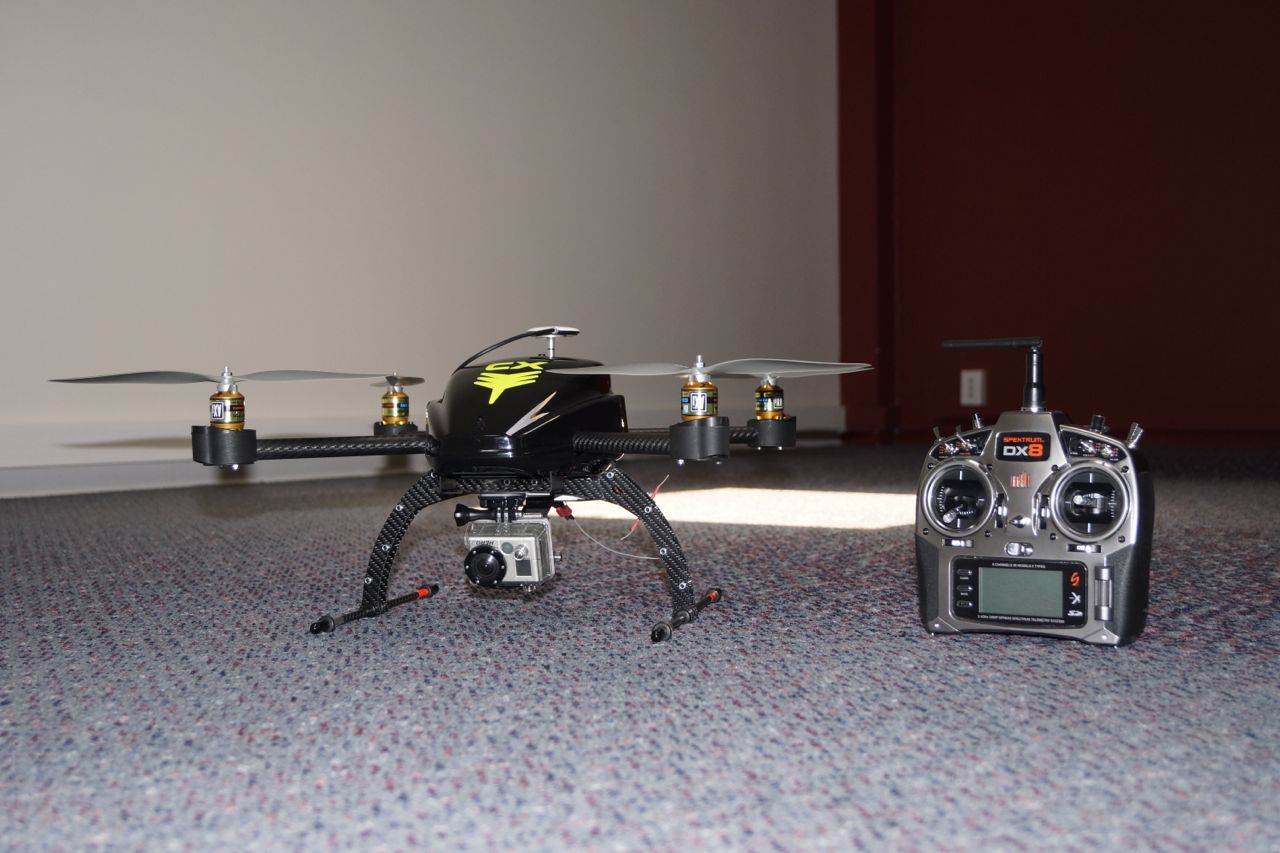

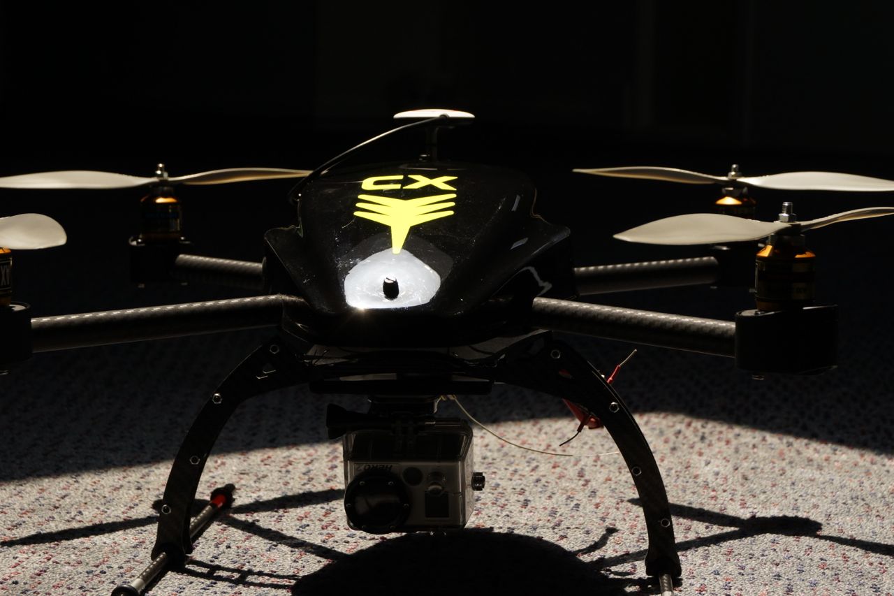

Hi Guys. I've recently finished building a CX4. I found that attaching the batteries under the shell was a real pain because the shell is so trippy (difficult) to get back on with the screws. Instead I've gone for mounting a 4 cell 4,500mAh LiPo
underneath and it's working really well. I get about 7mins flight time. The main problem I'm having is that when I switch to GPS mode (no red LEDs blinking) the CX4 starts to go in anti clockwise circles getting larger and larger till I'm forced to correct it. I'm talking 10 mtr circles and growing. It does this every time and I'm very puzzled by it. Even the DJI guys couldn't give any helpful advice.
