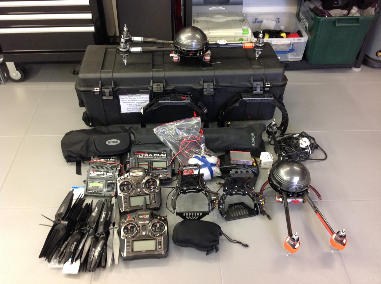

I am deadly serious and fly a Y6 why anyone in a working world where you have to shoot anything and everything would go go for an octo is beyond my comprehension. There is no way we could have done the peru gig with an Octo there would just not have been the room to transport it! If we had to compact out down it was only 4 bolts on the Y6 with an octo it would have been a mare to fold it up every time we moved location.
Full Peru gig kit in one 1740 Peli two Y6 machines and everything we needed to ensure the production got what they needed.
