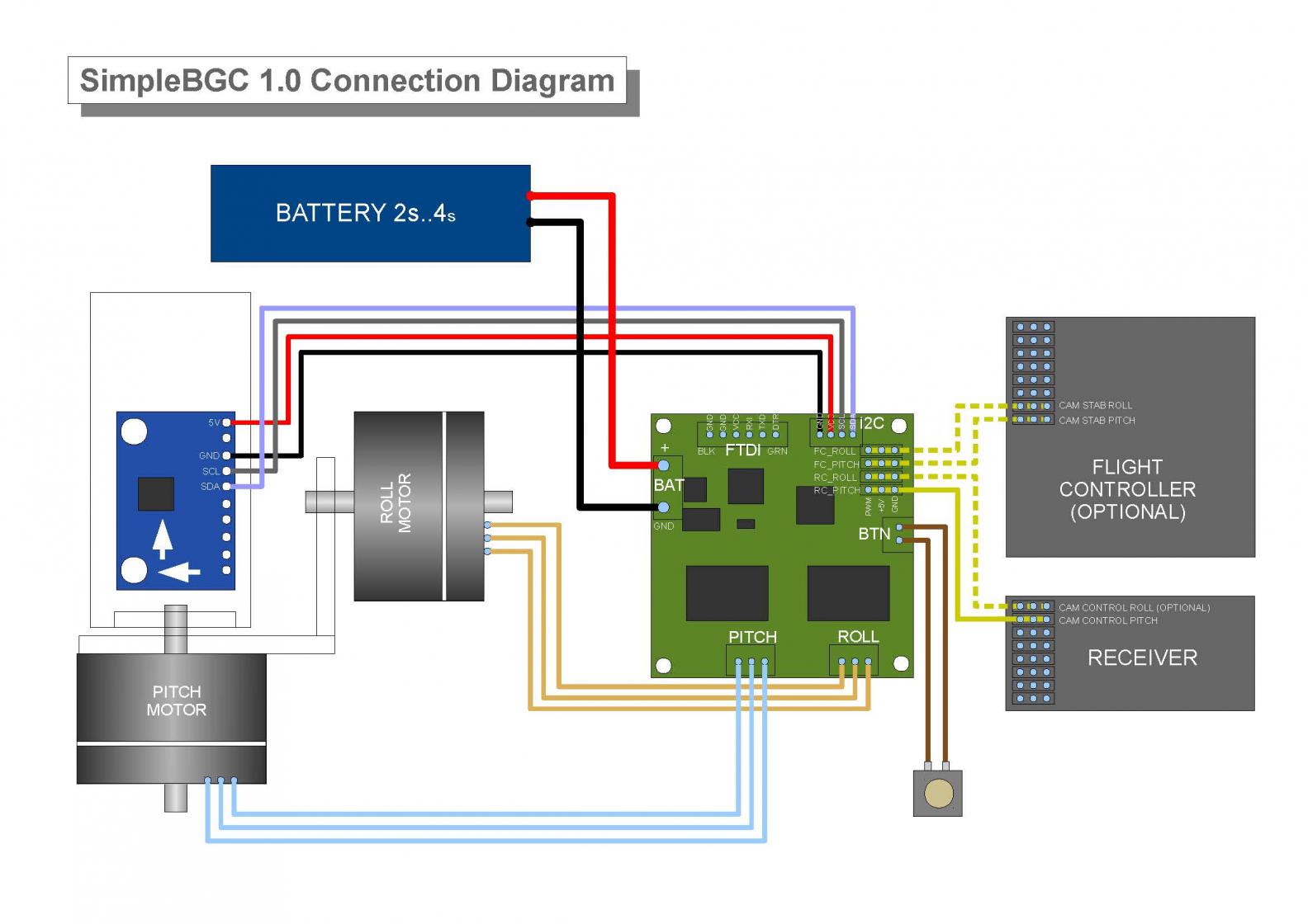

Hey Jfro, wondered if you could do me a favor - Can you run a volt meter across the +/- pins on your alex board and let me know if youre getting a solid 5v out?? Cant get my pitch to work and wondering if I've got a bad board.
jfro
Aerial Fun
Which pins do you want me to check. I'm assuming the 3 pins on the pitch, check 1 & 2 then 2 & 3? If so, is 2 the ground?
My copter is apart getting new 30 amp ESC's which are soldered. Should be done tomorrow and back together so I can check the alexmos then, if that's not to late...
SMP
Hey Brother,
Aye - Looking to check voltage either/both the Pitch and Roll Pins - On the Diagram its RC_Pitch with PWM closest towards the center of the board, +5v in the center and Ground closest to the edge of the board. I'm not getting my Rx to power up when I power up the board so wondering if the fluctuating voltage I'm seeing is the culprit. (or maybe the RX has to be powered independently from the board??? Seems like it would draw voltage from the board but who knows.. first time trying to get this board to tilt...)
Thanks mate!!!
