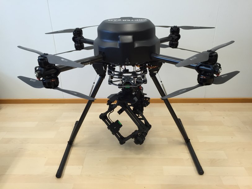

Tuomas P.
We have flown them for a while now, know the designers well and are in constant dialog with the factory. They are based in Tallinn, Estonia just 2 hours away from us in Helsinki. We have traveled and operated the frame in Europe and Africa. The frame can take extreme heat and be flown in almost any weather. I cant think of another one that could be assembled and disassembled in a few minutes as easy. Very happy with ours. Its super strong and well thought. The MC and IMU are located in a neat floating equipment bay removing any vibrations to the IMU. Highly recommended. We fly RED cameras with Mövi M5 and M15.
Tuomas / KopterCam Finland
