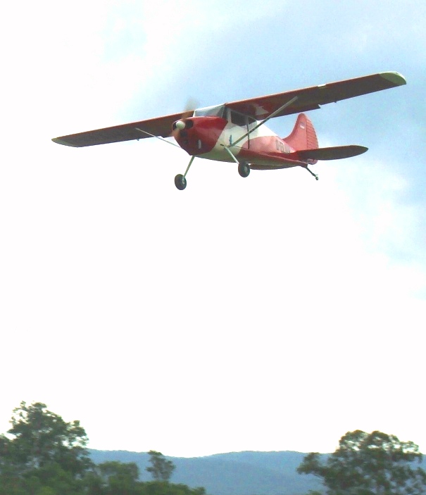

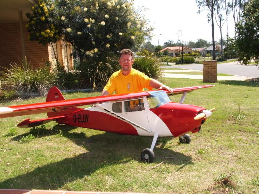

P.S. here is a pic of my baby. Cesna 140b 144" 62cc Zenoha DA ignition 25kg AUW

ChrisViperM
Pete, you are always welcome to ask anything you need to know....someone here on the forum will always help.
Big respect for your "baby" Cesna.....It's always great to see these bigger birds fly
