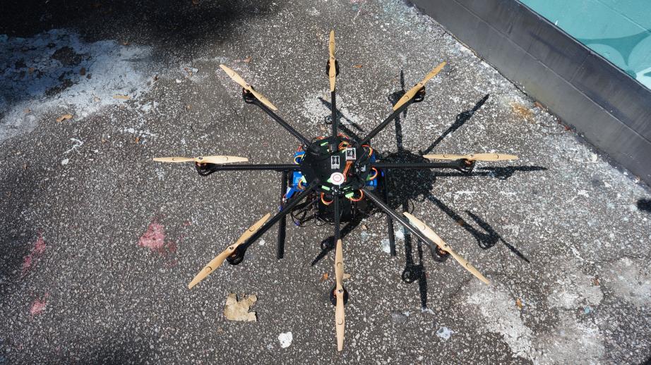

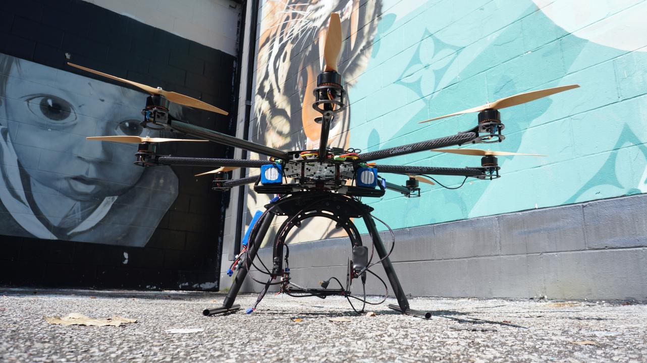

To follow up the thread I've managed to do another test with one of the lower motor unplugged and the prop secured in parallel to the boom - sort of 'feathering' the prop to prevent it's aerodynamic drag when it is windmilled by the upper prop.
View attachment 13163View attachment 13164
The end result - No change at all~~~ the Y6 still spins once it gets airborne. Therefore it seems to me that the spinning motion probably not to do with the drag created by the prop disc, but with some other reasons... perhaps a firmware thing?? But how the hell does it differentiates from upper and lower motor failure??
