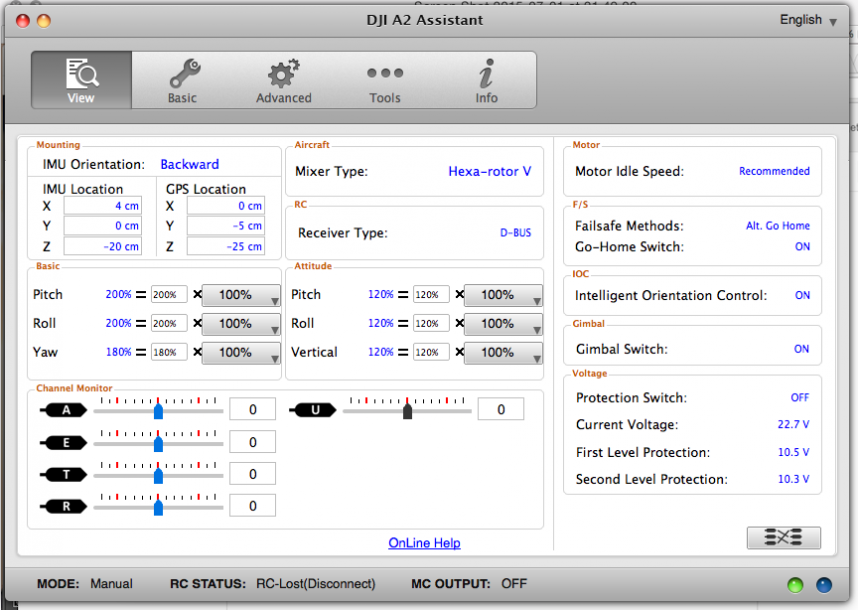

But when using a DJI A2 flight controller on this bird it becomes very unstable. It is wiggling (dancing in the air) from side to side. I have tried basic gain settings between 100 to 210% with no success.

What are your gain settings, where is the IMU located and how well is everything balanced?
The A2 is very much more sensitive to vibrations and proper set up in the GUI. Make sure your CGI is correct (it's not where you put the IMG but where it is on your machine, so is your IMU above the CG in the center, and if so by how much)
List as much info as you can and we can try to help.

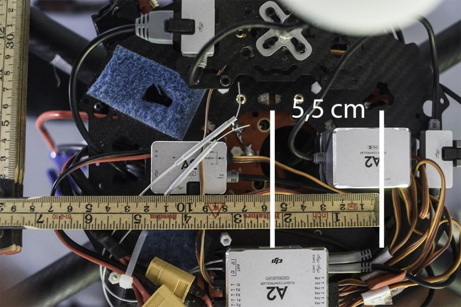

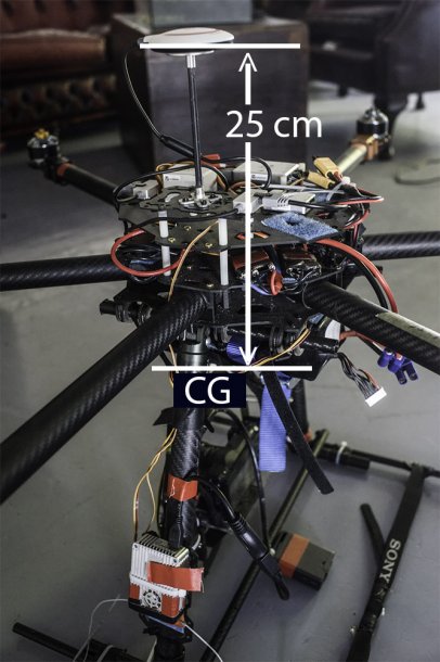

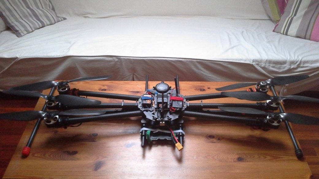

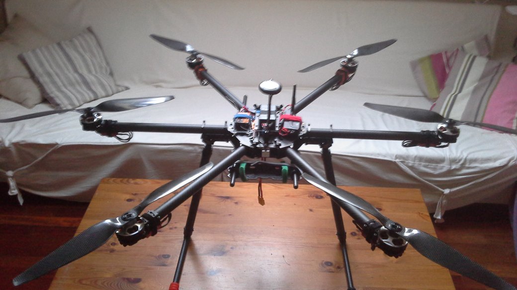

Here are some images of the hexacopter setup with the A2 flight controller mounted + numerics related to CG.
SETUP
I am also using a DJI Lightbridge and a 3G GPS.
COMPASS
The distance from the CG (X) to the compass is -25 cm.
COMPASS
The distance from compass to CG (Y) is -6,5 cm
(This value is -5 cm in A2 assistant)
IMU
The distance from IMU to CG (Z) is -13 cm
(This value is -20 in A2 assistant)
The distance from IMU to CG (Y) is 0 cm
The distance from IMU to CG (X) is +5,5 cm
(This value is 4 cm in A2 assistant)

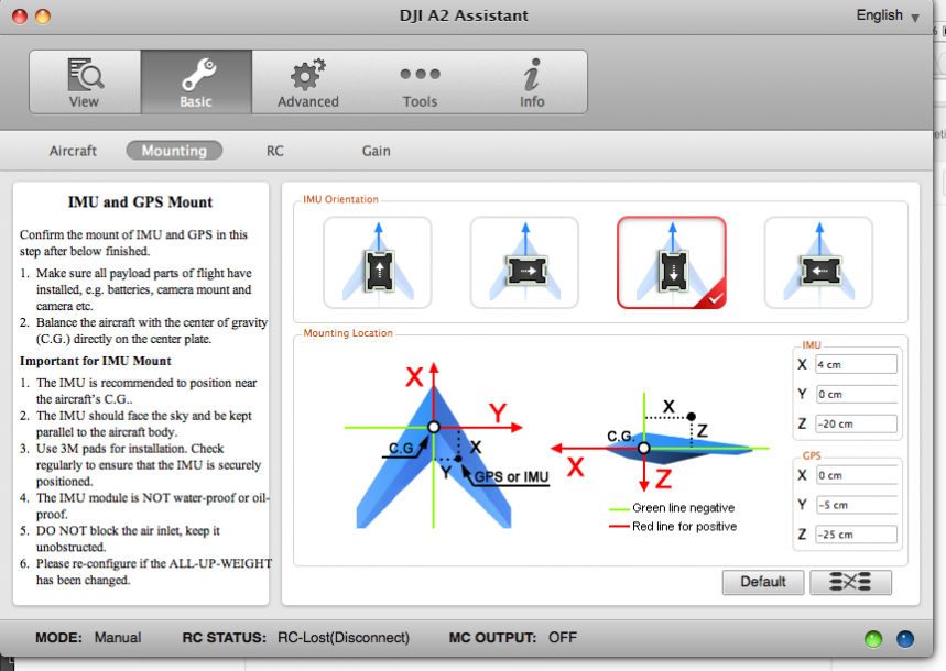

And some screenshots from the A2 assistant from the last flight

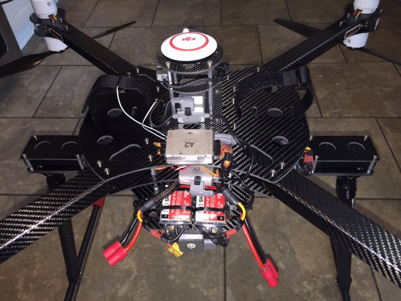

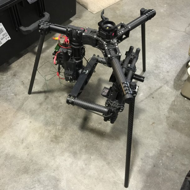

First I'd say move the IMU to the center. I know you can tell the GUI where it is, but I have never seen a rig fly properly with it elsewhere.
Also clean up your wires and components, believe it or not sloppy wires cause a lot of issues.
Clean and simple.

COMPASS
IMU
[/QUOTE]
why are your measurements different in assistant?

Here are some images of the hexacopter setup ....
I cannot say that I have had any significant issues with the A2, certainly no more than the WKM, and my IMU is never mounted central. Some folks seem to be able to get away with basic double-sided tape for mounting the IMU, I always use Kyosho Gel to help with isolating the IMU.
Your Basic gain settings look a bit high and the Attitude settings a bit low. Try starting with the recommended settings before venturing any changes.
And for God's sake clean up that bleeding 'orrible mess.
