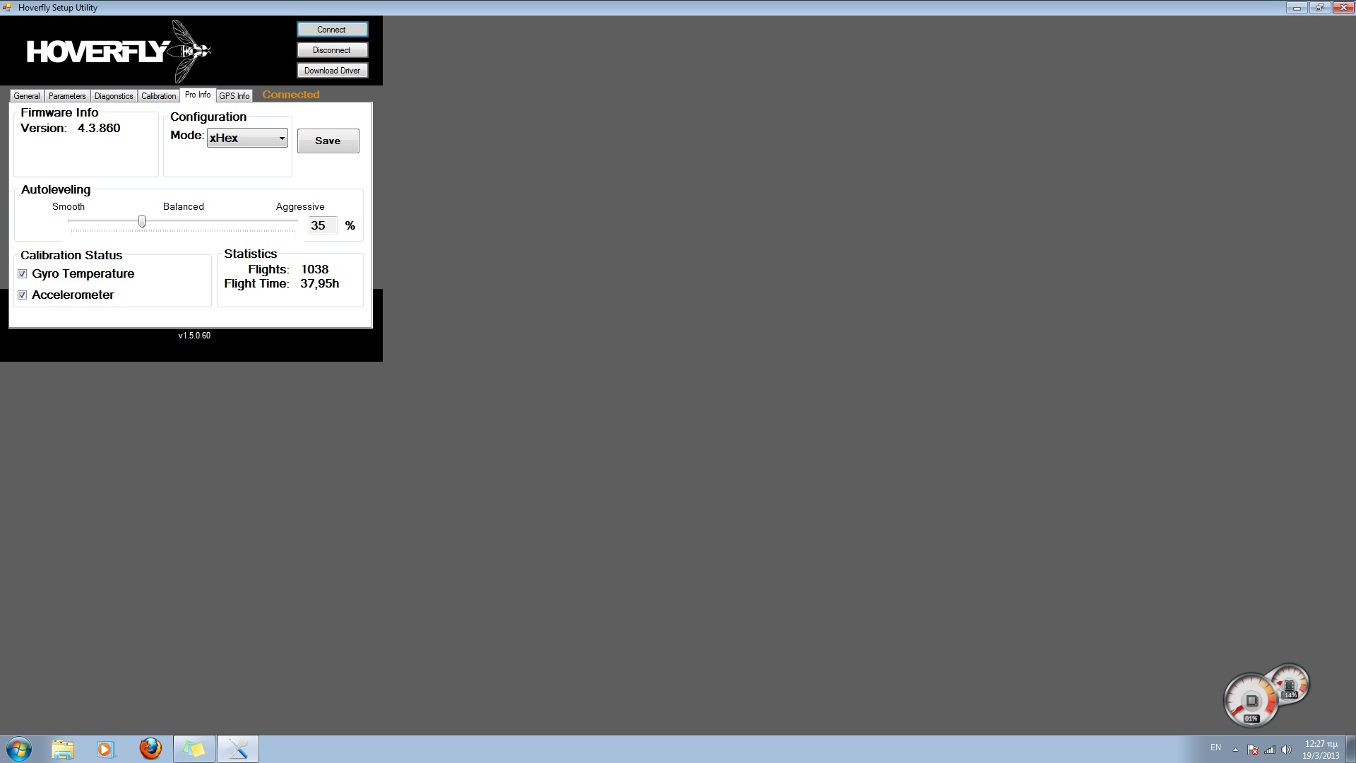

this is the story .. a week ago I did the Firmwareupdate V4.8 and immediately made all Acceleration and Temperature calibration..also trhrotle calibration made.
I went to fly and after 5 minutes flight without any warning suddenly made ​​a fast circle I thought that was throtle calibration and i made one more..so I noticed something else today I went to my parents' village for tour and to do one flight after having had perfect weather ... as you can see at the picture below i have made over 35 hours with hover fly pro without any problem..Never. i have NO GPS on board

Thanks for your comments ! All props have carefully balance both axes ..i think that to make upgrade again for me is a nightmare ..no more thanks !!!as you can see in the picture above i have almost 2 years with very successful flights without a single problem...this is happens right after the new firmware..i am 1000% sure that is a software malfunction ... immediately after I installed the older version .. I flew at the same place the same altitude ,same distance and nothing was happens all normal ...
