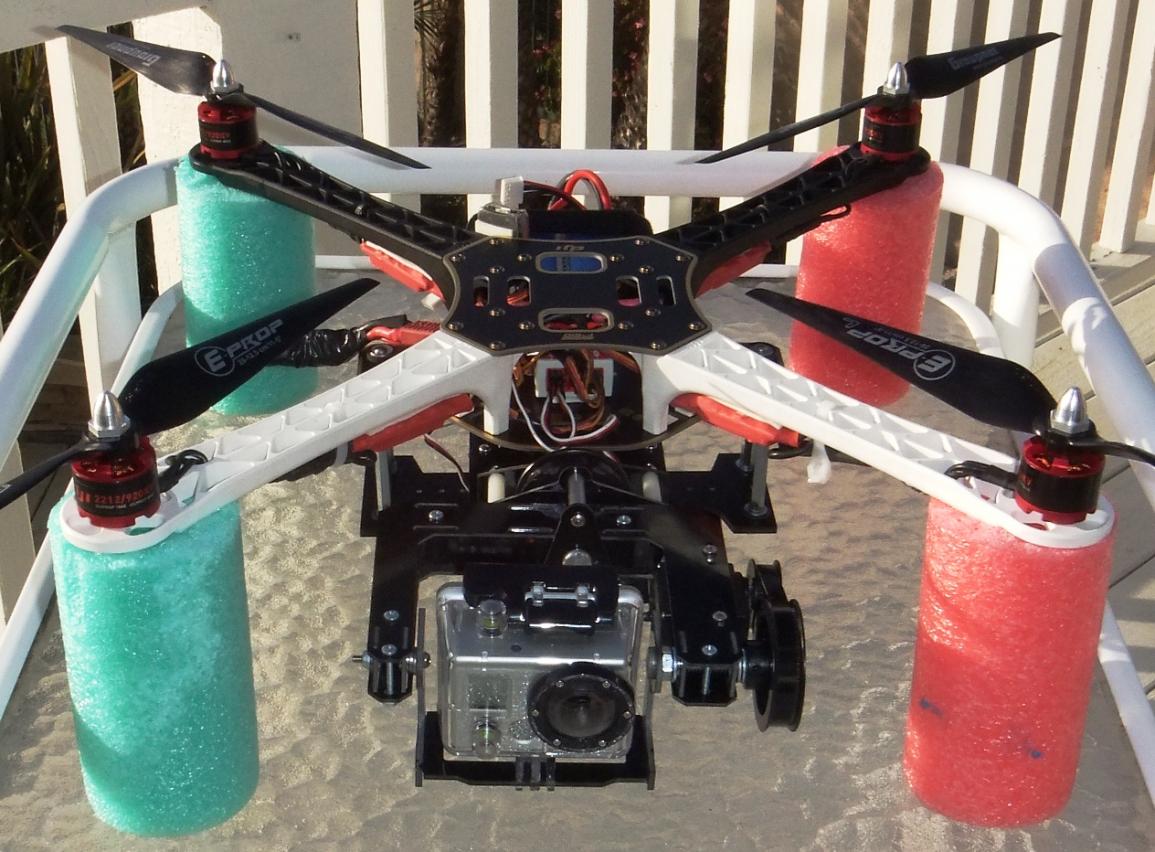

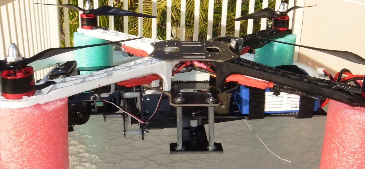

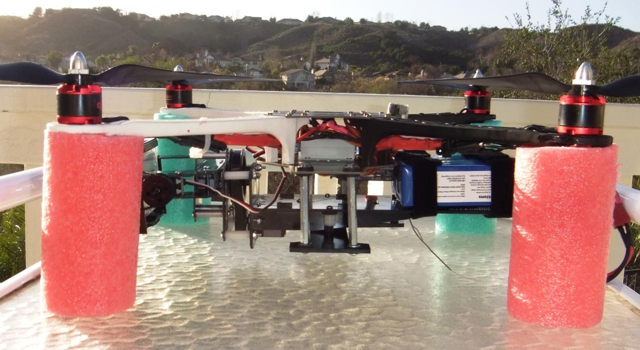

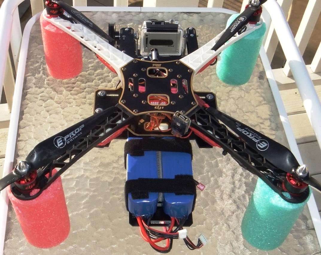

If you can wait a few weeks, we might have another option for you. I've been delveloping a higher quality, 2-axis, belt-driven gimbal with Andrey Kim (Askman...) The initial one we are testing now is tailored to a GoPro, in its waterproof case, and is oriented as a "nose mount" configuration in order to mount on the front of a DJI F450 quad. We are doing a slightly larger version of this gimbal that is sized to be mounted under the new DJI F550 hex. This version, which has an integrated set of landing gear, is sized to carry a NEX-5N/7, a GH2 or a 550i. There's actually a lot of commonality between both sizes, and they both use a common mounting setup, with special vibration dampening plates. This means you can mount the GoPro yoke/tilt assembly on either the front-mounted quad setup, or on the LG-equipped hex mount. eventually, we are also going to do a "full-size" DSLR variant, which I plan on using with my CineStar 6.
I'm in the process of building up the DJI F550 hex right now, actually, and Andrey is cutting the new LG this evening. I will hopefully have the first completed hex/NEX setup flying this weekend. The testing on the F450/GoPro version is pretty much complete. We've made a few more minor changes, mainly in the mounting plate assembly, so that we could make these common, across both sizes and platforms. Anyway, Andrey should start work on the 1st lot of the F450/GoPro version next week. I am in the process of revamping my old TPpacks.com site, which we will use to sell these, hopefully starting next week. I'm also in the process of signing up as a site sponsor here. :)
Attached are a few pics of the F450/GoPro version. Also, there's a thread going for this already in the DJI forum: http://www.multirotorforums.com/showthread.php?1973-New-GoPro-specific-2-axis-gimbal-for-the-F450...&p=21672&viewfull=1#post21672

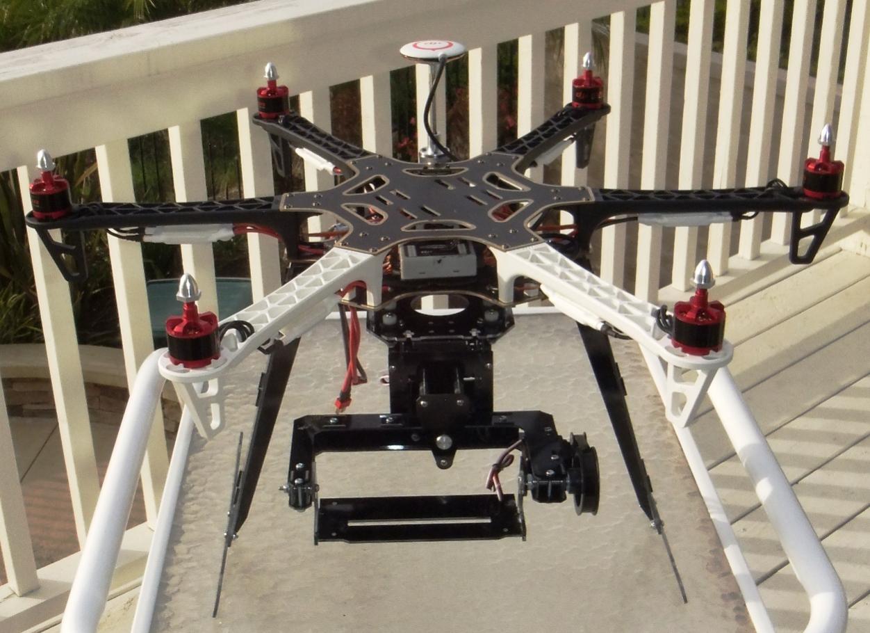

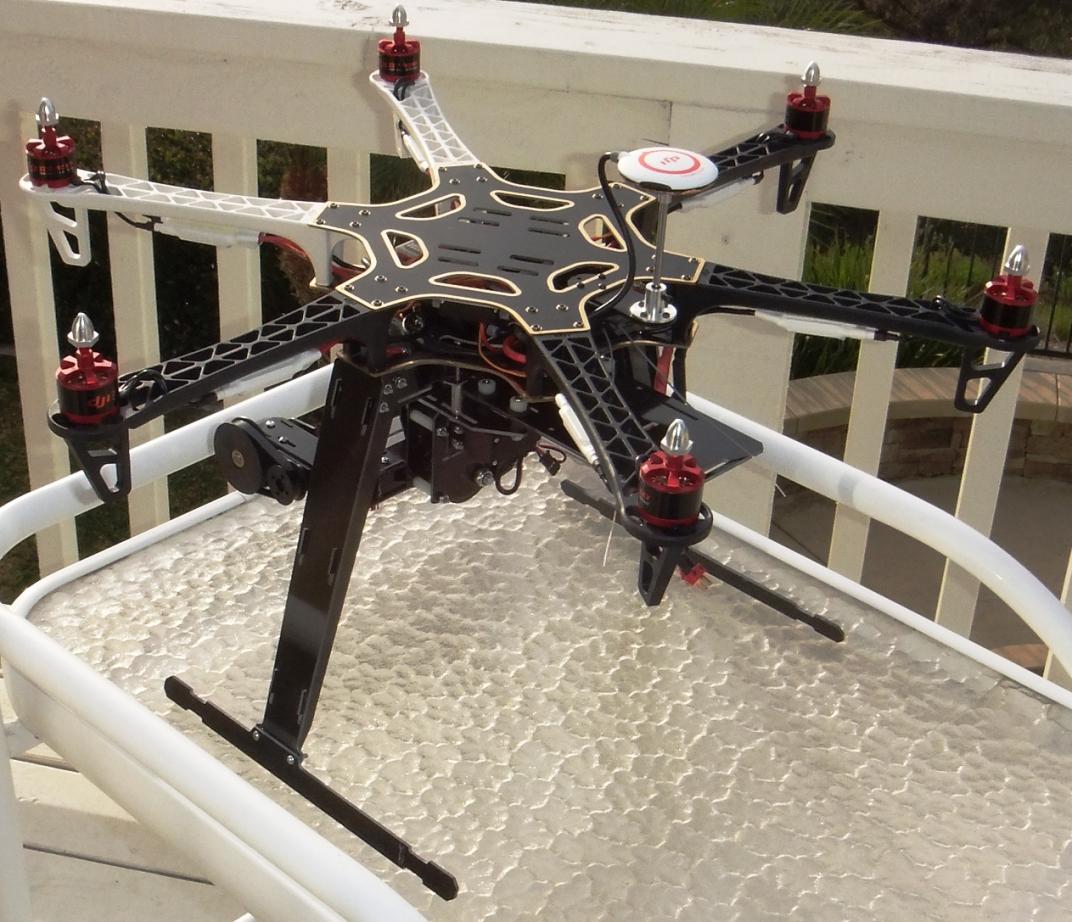

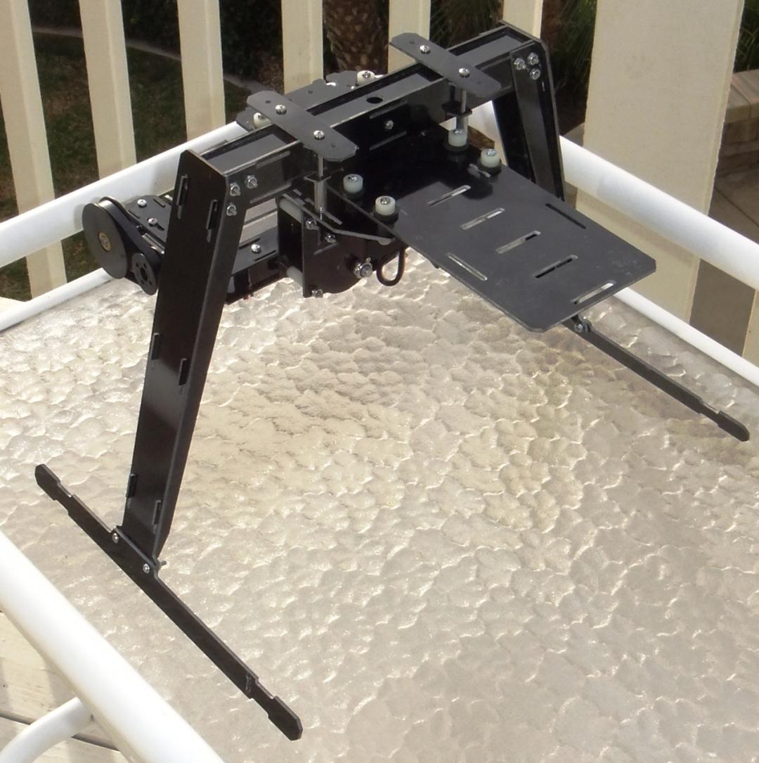

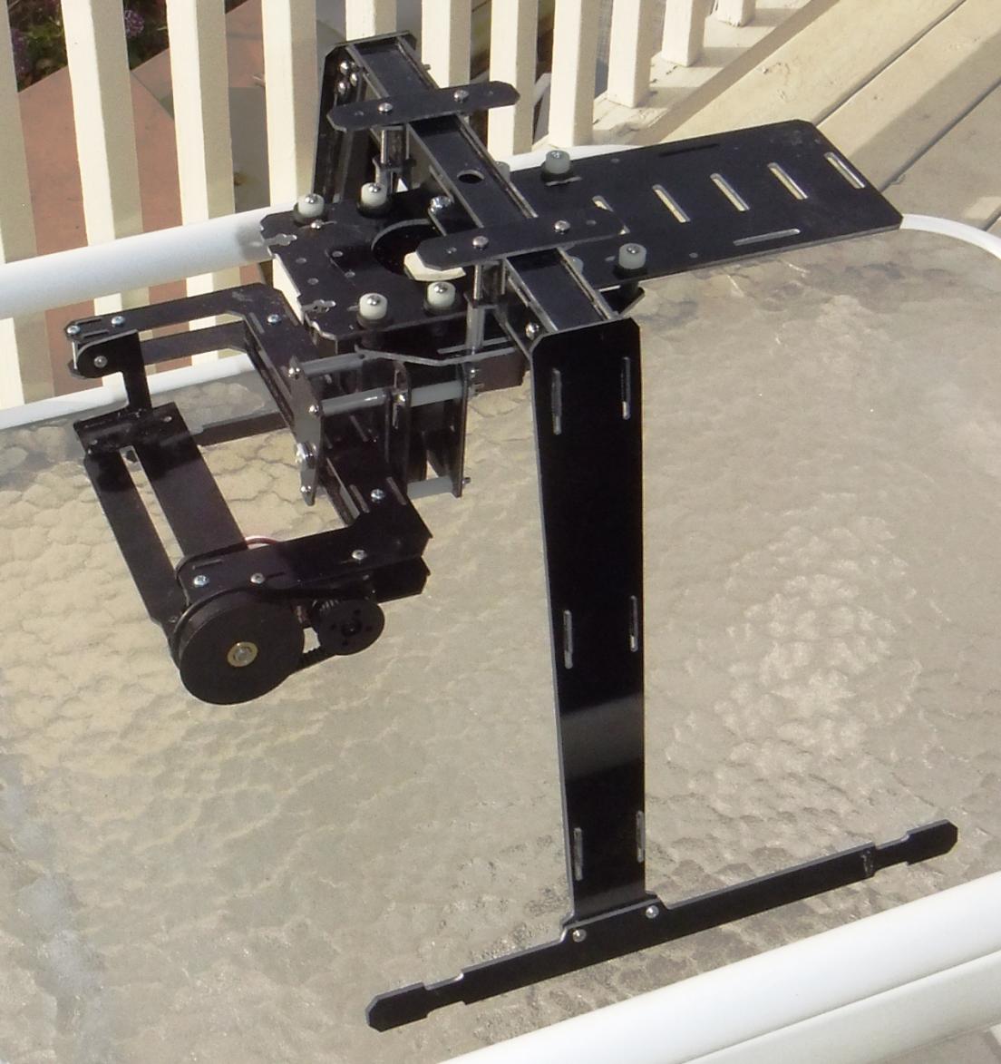

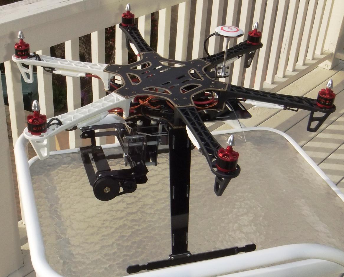

Attached are a few shots of the new NEX-5/GH2/550D gimbal, with the integrated landing gear. This is mounted underneath a DJI hex frame that I just finished setting up. there's a lot of commonality between the GoPro and NEX gimbal assemblies. The roll axis is identical. The yoke and tilt assemblies are the only difference. The mounting plate/battery tray is common as well. For the inline F450 option, the roll assembly is mounted at the front of the plate. When used with the LG, on the F550 hex, the roll assembly hangs underneath the plate. There will also be a 3rd axis pan option for the LG version.
