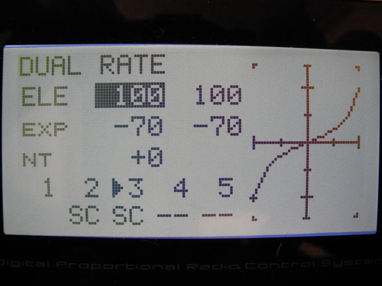

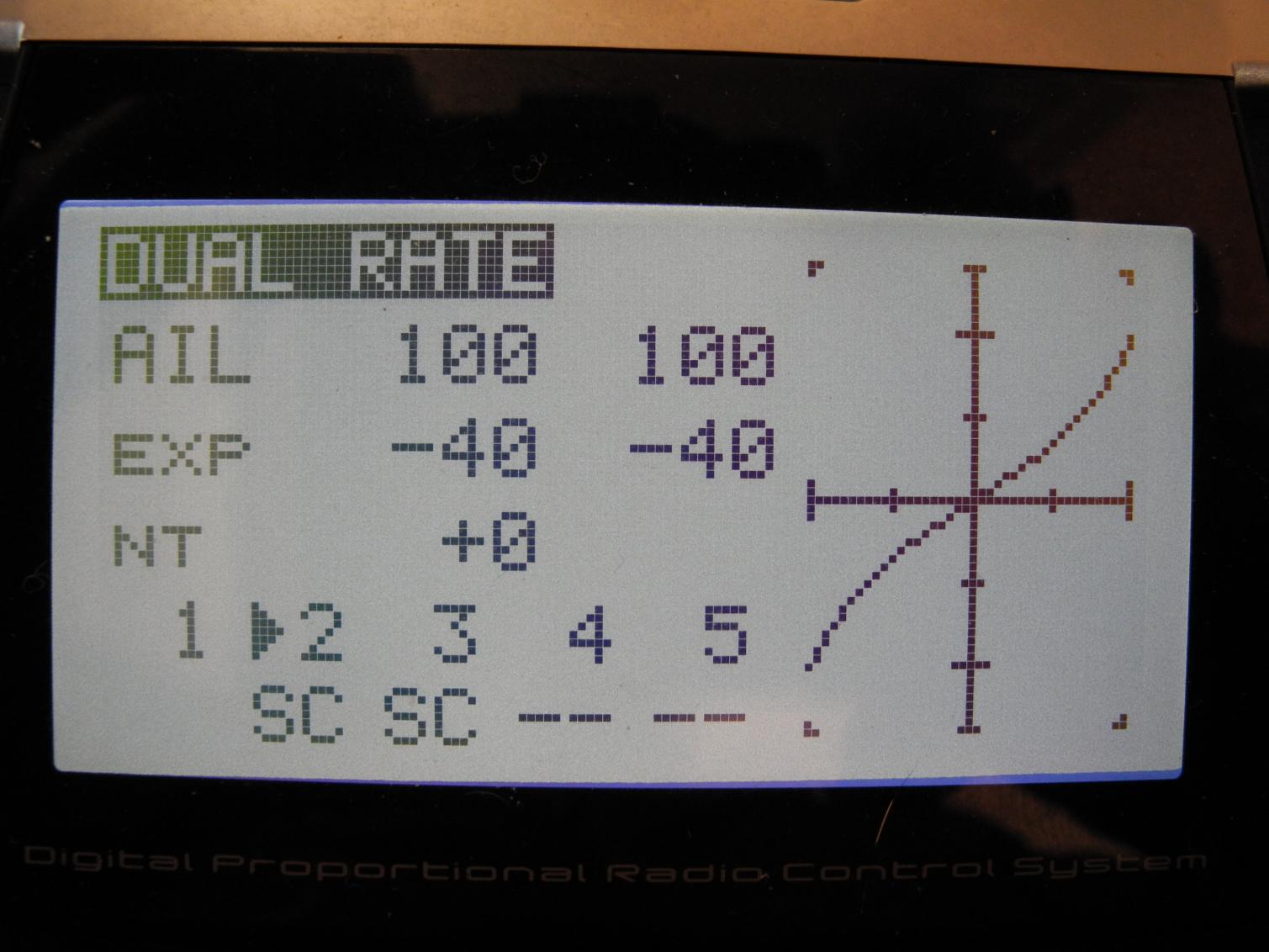

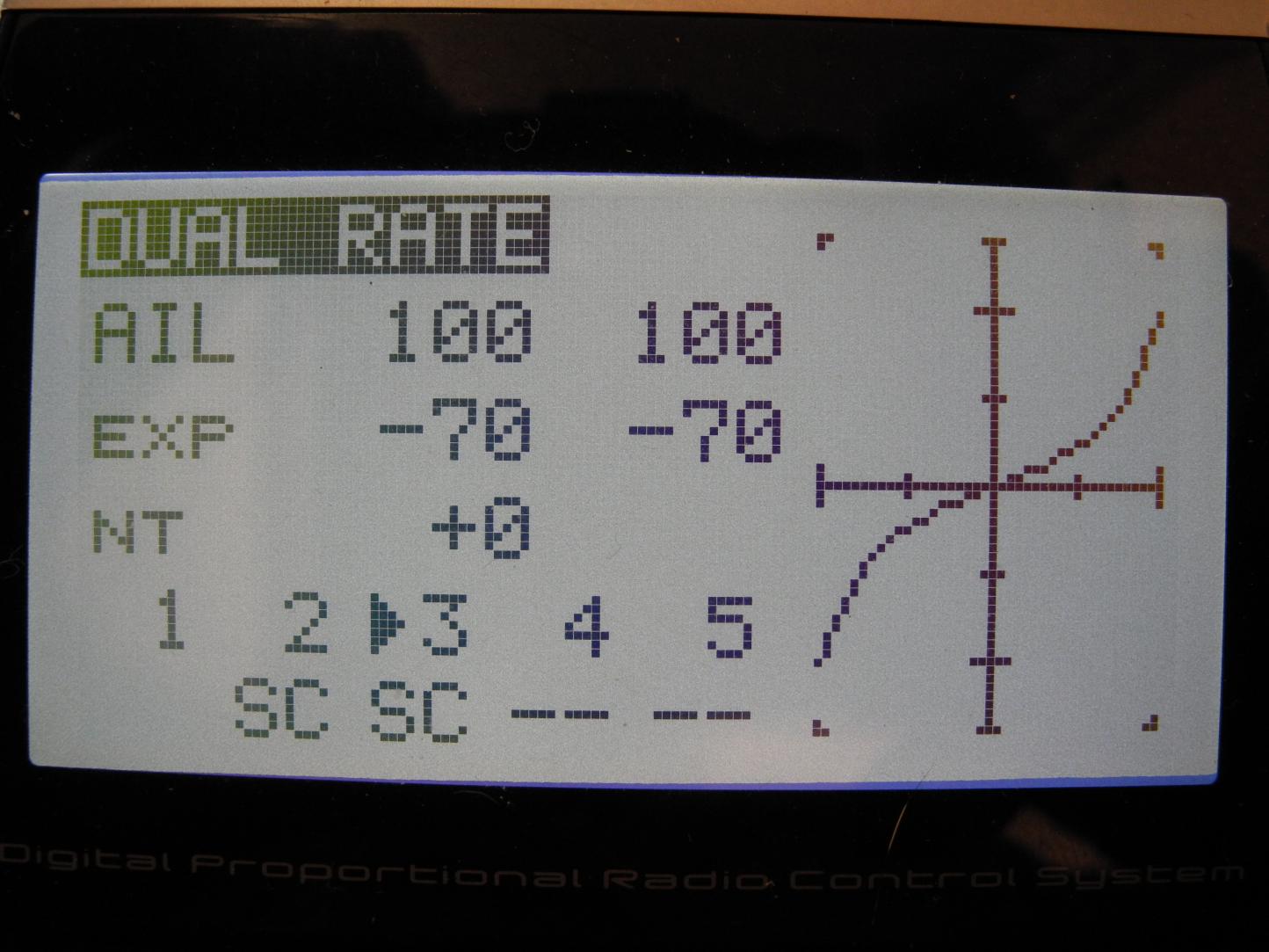

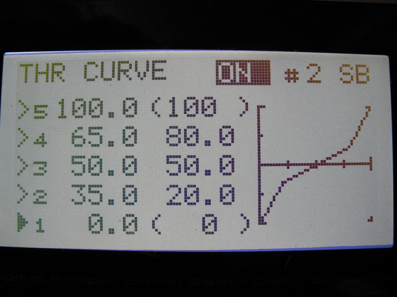

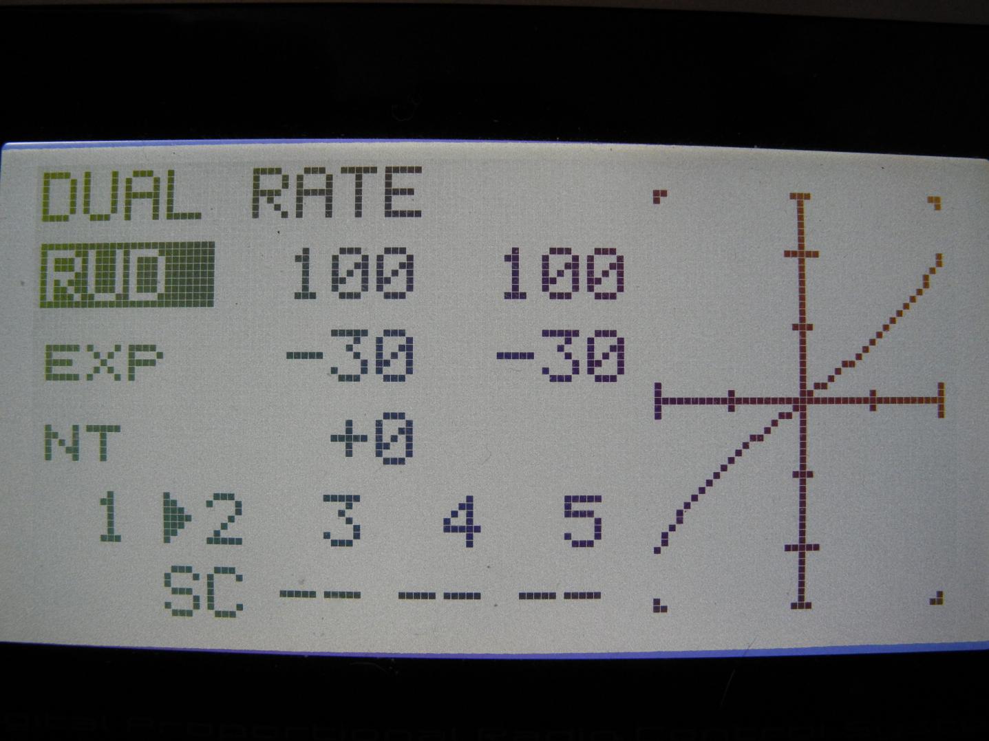

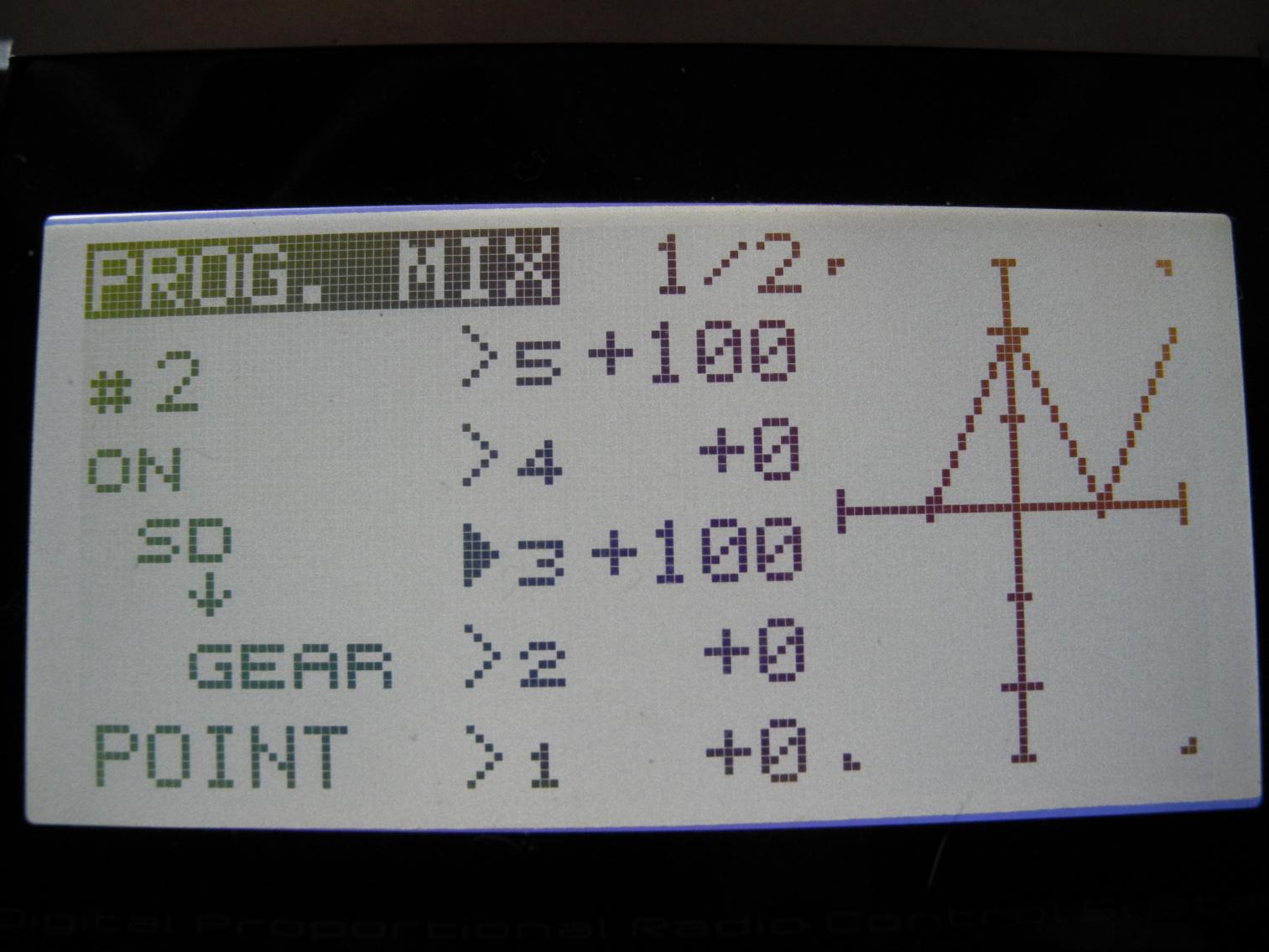

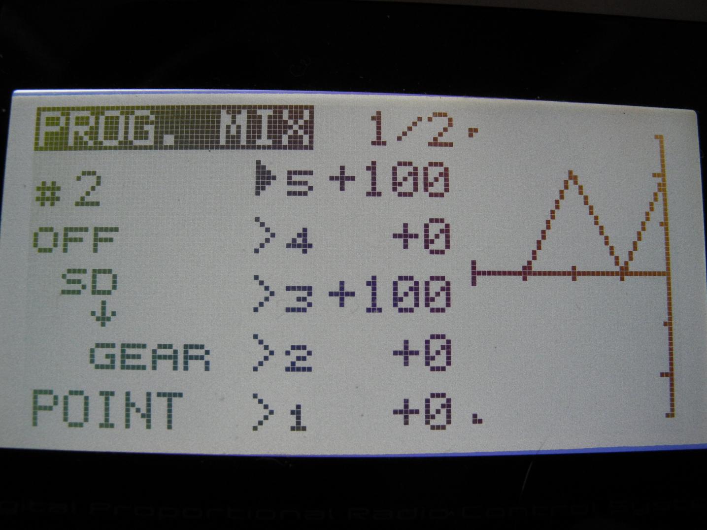

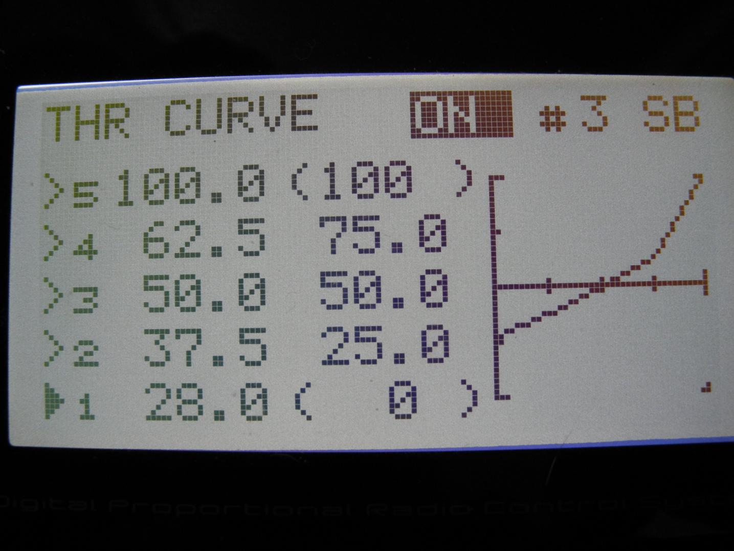

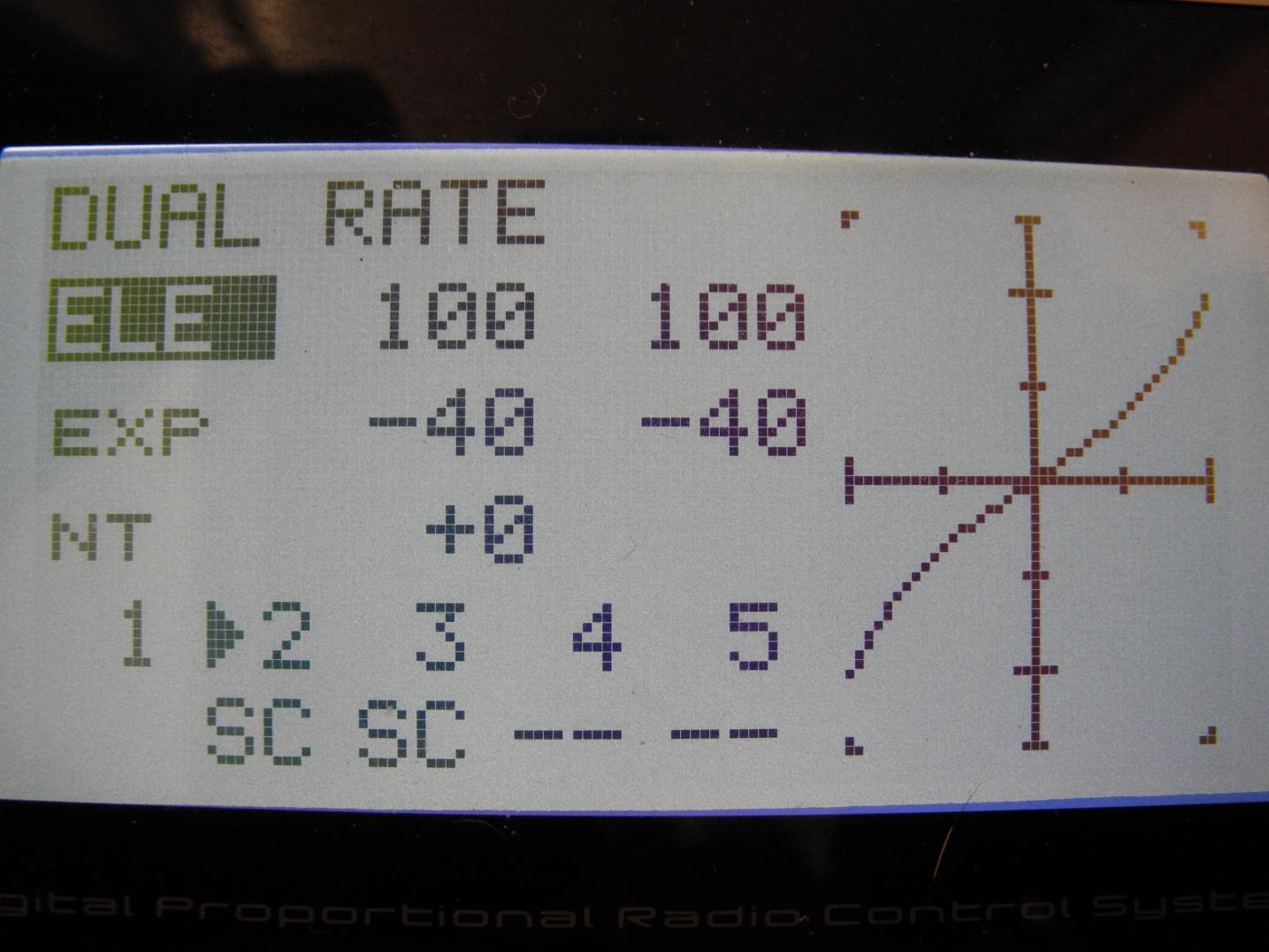

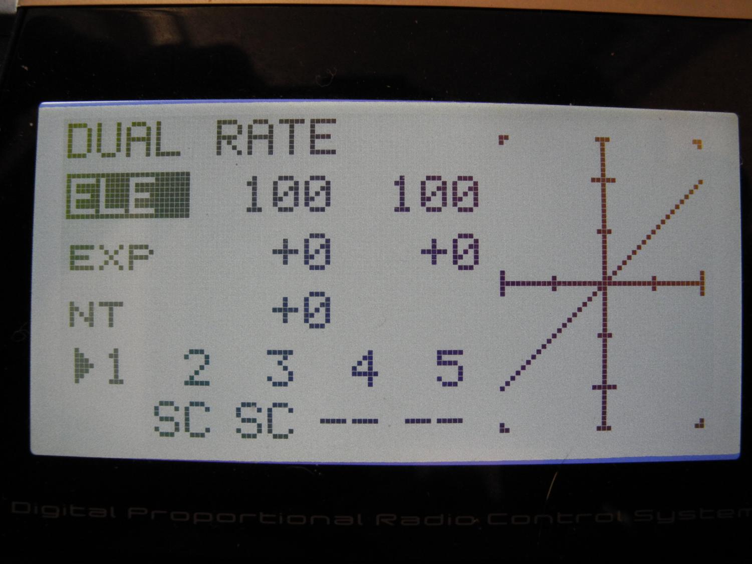

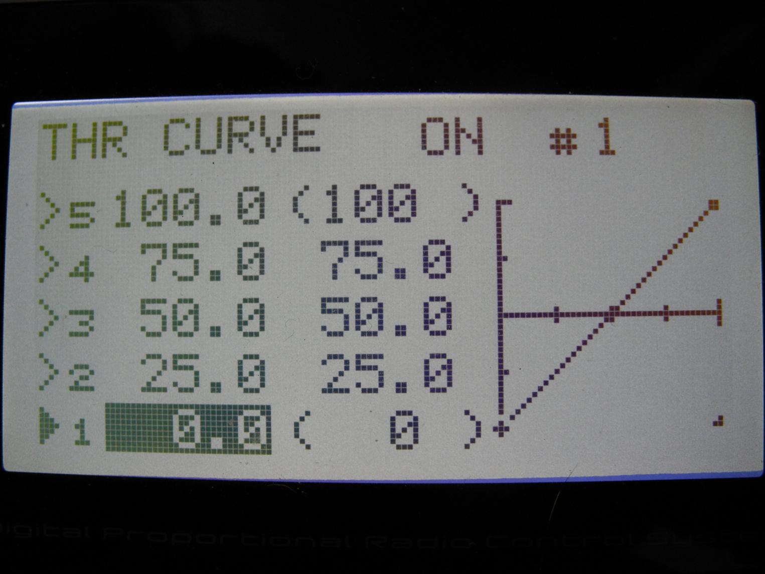

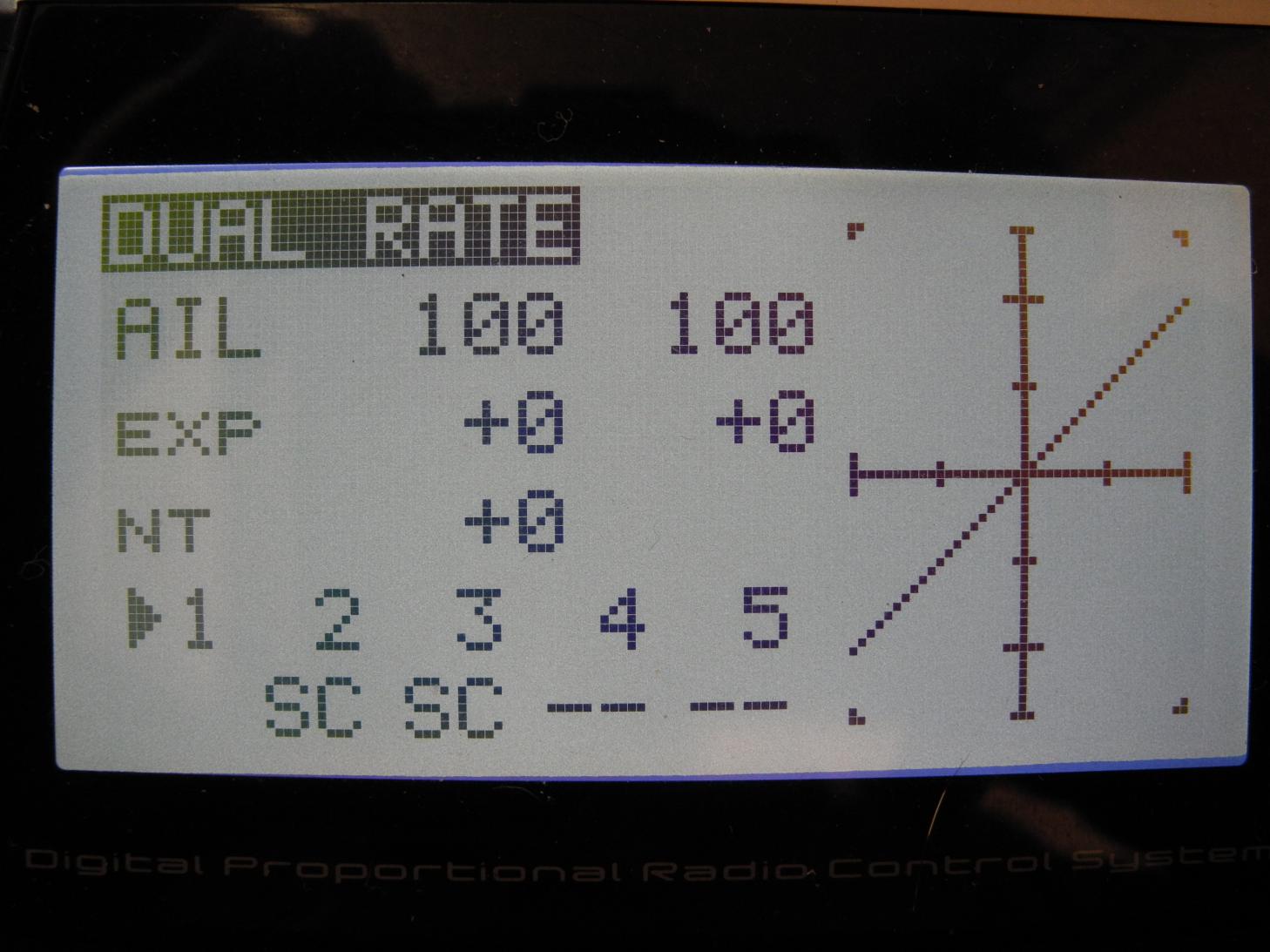

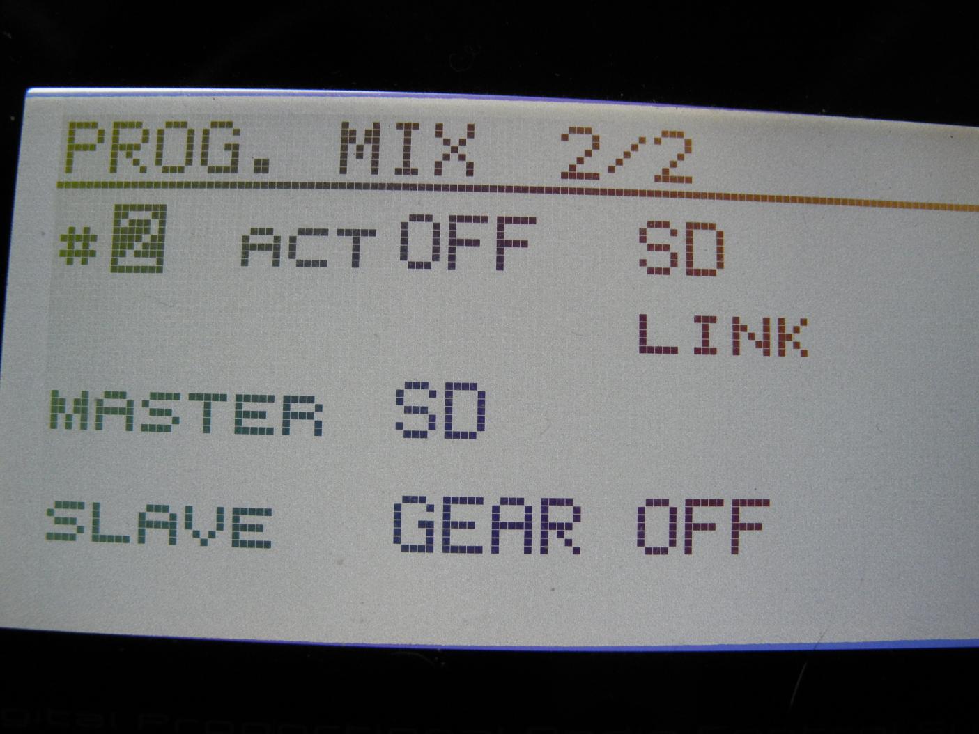

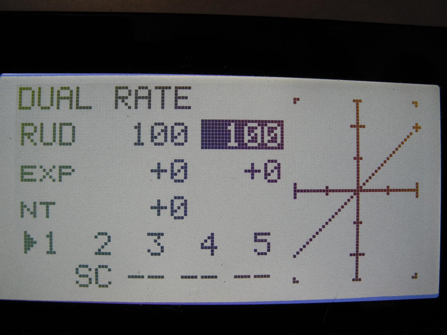

You know... This is how new I am to RC. I've been calling them curves... It's Dual Rate. Here are some pictures of my setup you can use....
The first three are the dual rate for the aileron, the next three are for the elevator, and the next two are for the rudder. Notice on the rudder, it only is affected by the last position of the switch. My thinking here was that if I needed VERY smooth movement, I'd flip the switch to position three and it would include a yaw (rudder) curve for smoother rotation. I've found I don't use this much. Notice I'm using the SC switch right above the right stick. Also notice with the switch down (position 1), everything is linear like out of the box. You can see the little arrow at the bottom in position two and three. Also note, on the rudder, the little arrow points to 2, but the first position and the second position don't affect the rate. Only with the switch all the way up (I call position 3) does that even come in to play. I don't know why as I'm a rookie. You may not even want to mess with that.
Next three are the throttle curve... Notice that it's on the SB switch right above the throttle... in position one (all the way down), it's simply linear. I found it difficult at first to keep altitude, so I would take off normally and get near a hover, switch the switch to middle position and get a flatter response from the stick. I found it MUCH easier to maintain a specific altitude this way. I have the T8FG as I thought I may at some time fly airplanes. It has the detents on the throttle unlike the 8FG which is smooth (I think). I have gotten to the point where I can get it between clicks and manage the altitude that way. I find I don't use it much anymore but it did help me when I first started flying. Be careful about placing all switches to down as you'll get a surprise if you keep it in the middle and lift off. It'll rise faster than expected until you get to the middle range. Also not that on the last position (all the way up) the bottom end doesn't even make it to zero. You do get a real flat response in the middle but may not be able to land. I don't use that one much either but it helped at first.
The last 4 pictures are my "three position switch acting as a two position switch" for auto level purposes and altitude hold purposes. The first three are the points and the last is the second page.
In all these, I just mucked around until I figured it out and verified it with the Servo Screen.
On another note, I have the gain trim set to a knob which I used in flight to adjust the gain 'on the fly' it worked pretty good and I landed and noted from the servo screen the value with the trim mixed in. I then set this value to the main gain endpoint and it worked perfectly. It was hard at first knobbing around and keeping the craft in the air. Do what works for you...
In any case, I hope this helped a little... Have fun.

Thanks for the Pics. That helps a lot. I think I've finally got my radio set pretty much the same. On the 2 position switches, I've had mine set to down, as off, and middle and up positions as on.
I'm wondering if I take and make a copy of these settings, then go back and set reverse to normal, if I might be able to use this on my simulator and see how it feels. I'm assuming it would work. Any chance you've tried it.
Before I started this tonight, I tried saving my settings to an sd card. Tried 2 different cards and the 8fg didn't recognize either one of them, but my computers do. Gonna have to chase that one down. Says it turn off radio, insert card, turn on radio, and it will ask to format card. Doesn't happen. It then says it will show up on LCD screen to show card has been inserted.
It's a lot to absorb. I'm a little leery of the top position, esp for throttle and elevator. Have to think about that. it's late and I'm fried, so I'll pick this up sometime tomorrow and hopefully get in a flight or 2 in the next 48 hours. Weather is trying it's best to be winter again around her for a day or two. Yuck.
Expecting camera gimble here late in the week or next monday. fun stuff! Once that's on, I need to find a permanent and doubling up of battery mounts. Still haven't figure that out, but wanted to wait untill I saw what I was going to do with the camera mount.
Thanks again. You have been very helpful.
Webheadfred
Air Traffic Controller
I haven't tried saving anything to an SD card yet. Probably should... But... The newer fast SD cards only work in devices designed to take them. I know one of my cameras won't recognize the 32g SD card I use in my GoPro. That may be the issue there. Try a slow plain 1g SD card and see if that works.
Yeah.. On that 3 position switch.... Looking at the graph, it's look odd... But think of the switch as a stick that only has a full down, a middle and a full up, and then look at the zigzag line. Left side (full down) is zero or off. Moving to the right on the graph at position 2 you'll see a zero but since our switch doesn't hit that, it doesn't take effect. Further right on the graph, position 3 is out switches middle position and the value is 100 or on. Position 4 not used and position 5 would be the switch full up position and again 100 or on. So either position, middle or up, would engage Auto Level and I don't need to worry which one. Full down is off. Either is on.
Have fun.

For the 3 position switches, I have 0, 100, 100. Which means down is off, middle and up is on.

I've tried putting my throttle curves on a switch and the switch seems to have no effect. It just stays in throttle curve #1. Any advice for me?

Hey Ben... I'll take a look at my radio when I get home about 3. I think you have the 8fg super like I do. I have mine in a switch and it works fine... I'll get back to you.

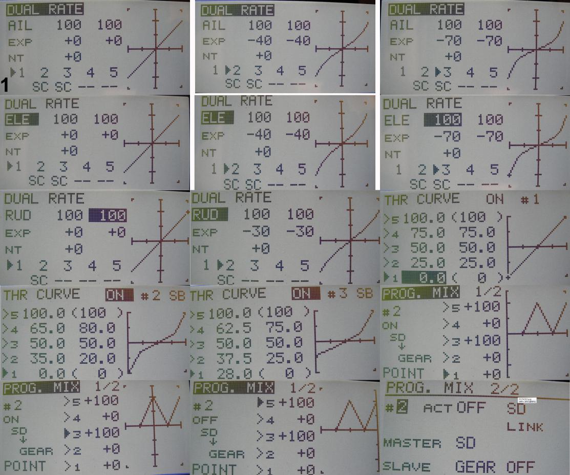

Look at 3/27/13 post on first page of this thread....
His explanation and photo's are all you need to do. I just went a flew a quick battery in my back yard and turned on the throttle curve, and it works. I also verified it on the radio under servo. You can see the numbers on the marks...
Here is his 15 jpegs in one file, it was easier for me to read...
Thanks again Webheadfred... You went beyond the call of duty for helping...
from Webheadfred:
