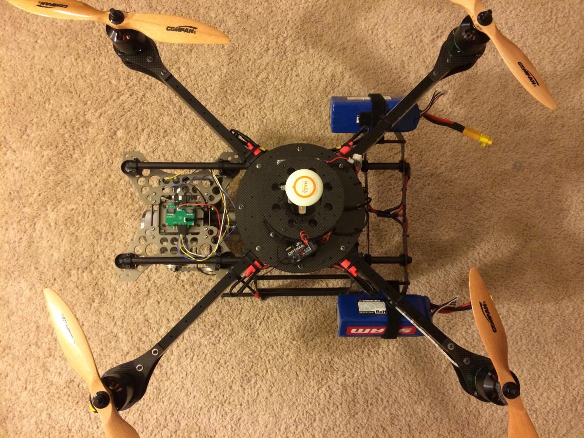

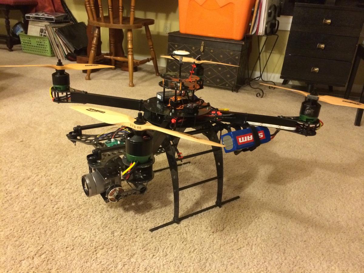

It all started with a sale at MontoRC on a few clearance items... namely a HUGE savings on Cobra C4120/18 540kv motors.
If you have never seen these things they are MONSTERS, very quality and smooth as silk!
So I slapped this guy together with a used VulcanUAV frame (cut down to 700mm)
As I mentioned, the motors I got on a blow out from MontoRC ($28 each as there were only 4 left usually $139!)
4 Maytech 65amp SimonK ESC’s I had laying around and a Naza 2 from an old review... I spent some time figuring out what I could build and it actually came out awesome!!
14.4LBS READY TO FLY with (2) 6000mah 6S packs, NEX5n and 2 axis gimbal and it flys GREAT!
ACTUALLY WITH 13/4.5 PROPS THE THING IS BALLISTIC!
According to the motor data it should have no problems lifting an AUW of 27 at around 80 - 90%, so the 14.4 is spot on!
12 minutes with time to spare.
Don’t ya just love when a plan comes together!!
