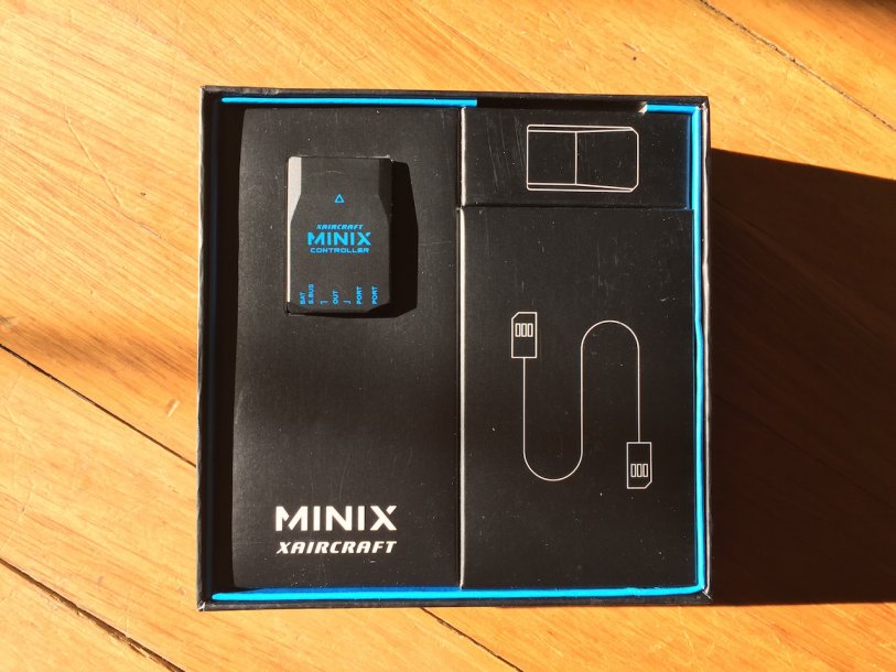

The unit arrived today and I’ll be checking the unit out over the next week or so and I’ll report right back here. First impressions? XAircraft continues to take Steve Job’s lessons and push on. Very slick “Applesque” packaging. The main unit is plastic (To be expected at a $200ish price point) and the included GPS has the LED built into it. BRILLIANT! Also included in my “pro” package was a TINY OSD.
The size of this entire package will lend itself to small rigs such as the popular FPV racers and such. But from my initial reading, the unit can handle up to some larger Octos!

I purchased my unit on Ebay for $210 It came with the FC + GPS + OSD and all the necessary cables one might need. I’ll mount it on a very simple and basic quad made from a Flitetest Elecrtohub, wood booms and some 2100KV motors I had laying around.
CHECK BACK!
