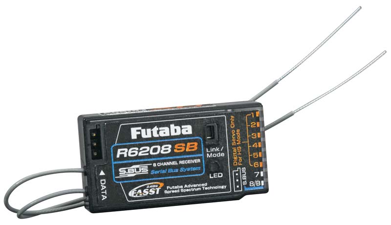

Hi, I must be a slow learner. I own a DJI F450, Naza V2, Zenmuse Gimbal, Futaba 8FG Transmitter with a R6208SB (SBus) receiver. Other than the SBus from the Naza nothing else is connected to the RX. I am in the process of installing a retractable landing skid that came with the Y cable. But before I connect anything I like to be certain that I am doing it cor rectly rather than being sorry later for not doing the homework. Are there any videos for the dummies like me that require simplicity, step by step procedure would be very useful. I did search the www but came up with nothing that provided me with the confidence to proceed. Hence the reason why I am trying this forum, any input is appreciated, tx View attachment 25996

The confusion is if you are using it in D8 1-8 mode then the 8 SBUS channels are mirrored on the 8 outputs. if you want separate 9-16 you will need to select it when you bind the Rx. Most of the time I just bind like this and pick a channel I'm not using anyway... then no need to mess with 9-16 mess and setting up all that stuff and you can trigger things together via sbus and normal channel output...
Without looking, I think it is D16 9- 16 mode, it will say that on the Taranis when binding.
