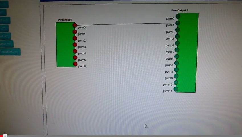

More progress: basic configuration editor.
Ignore that look'n'feel (now we need it working, not looking great - yet). But here's how we expect you to configure the system: web user interface. Getting to the eGCS, you take modules you want (for example, particluar input and output interfaces like PWM or S.Bus), connect them to the rest of the system (not shown yet), and connect their ports with the mouse. So you configure your system using WYSIWYG principle (What You See Is What You Get).
On the video below the PWM input module is connected to the PWM output module. So the servo signal is passed through. The 2nd servo is internally connected to the Test Output generating few steps per second, and it works independently.
Credits go to LinuxDrone Team, mainly to Alex (architecture, web editor draft), Voha (C++ base classes), Sami (PRU-based PWM input/output modules and the video).
